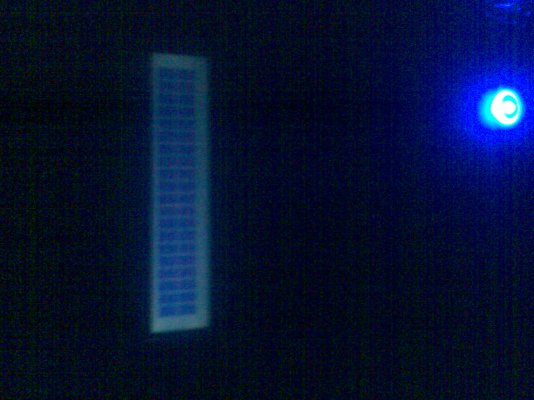

I am getting the error mentioned in the picture . The sound goes off while LCD displays as in the picture.After switching off and again switching on it goes on well. But again and again causing the same problem..Any idea......

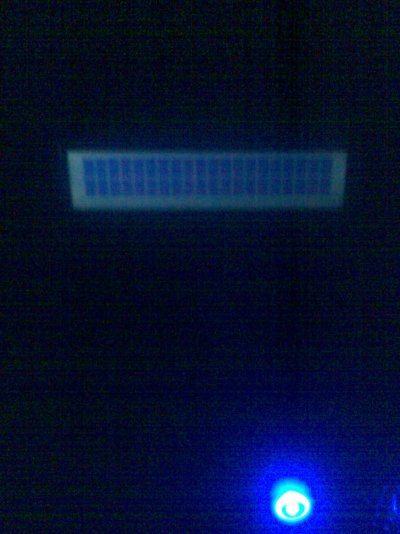

The error is that sound goes off and control pod LCD displays only blue squares on whole screen (just like in the picture).
After switching off the power and again switching on the power of speakers it works well for few minutes but again the same problem, then I stopped using the speakers for 2 days and after that I have not faced this issue again.
What do u people think that this error will be repeated or not and if repeated then what should I do?
Is this a heating issue?

Touch the backside of the woofer, if the heatsink is very hot, then its heating issue. u said it comes back to normal and again goes off after some mins so seems a heating issue.
No, speaker system doesn't goes off but only sound goes off i.e mutes, while the speaker system remains on but without any sound.
After switching off the power and again switching on from backside of subwoofer (power switch), it works fine for few minutes and after that again same problem......
The problem is not solved automatically i.e I have to manually switch off the power and then switch on, after that only it works, but for a very very little time and again the same problem repeats.
