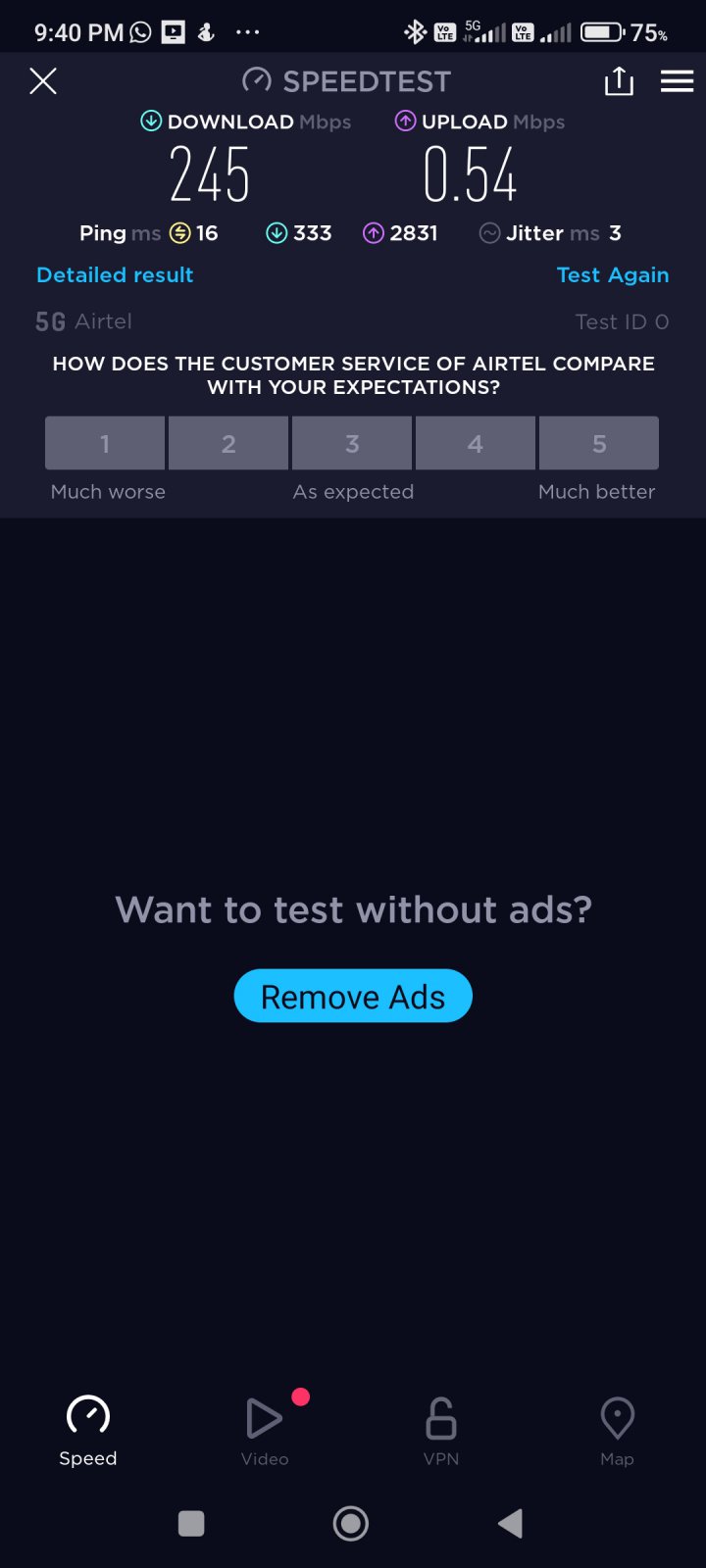

Here it is. Phone is Mi11x.
Cool. The app shows the 5G is NSA. And that explains how mobile is using VoLTE despite being on 5G.
Very good
Your 5G is on band B3 which is 1,800 Mhz. Airtel is using B3 for 5G :wideyed: Oh Happy days :happy:
Course, nothing like a 3-digit frequency but can't have that just yet.
Your 4G is on band B40 which is the regular 2,300 Mhz
You will get better signal strength indoors on 5G than 4G, which means faster speed if available. Even if it isn't you get better penetration on B3 than on B40.
Now, using a lower frequency should translate into battery savings but due to the NSA the phone has to switch between two frequencies instead of sticking to just one.
So the battery will go down faster if you use voice on 5G compared to VoLTE on 4G otherwise just data on 5G will be better than 4G.
