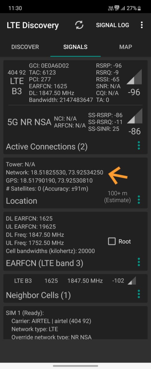

Post the LTE discovery screen grab for your location
It helps to understand the correlation between speed and bands used

You should see the band info on the top line. Post a screenshot.
I'm not sure which frequency is being used for 5G in your case. LTE shows a signal strength of -96 dBm and then there is a 5G strength of -86 dBm which is a stronger signal.
4G works on 2,300Mhz or B40. But there is no B40 in your screenshot. Apparently, It's B3 for both. so why two readings for signal strength then?
Because the 5G is NSA the phone has to hold two active connections which will take a toll on the battery as opposed to just using 4G with VoLTE.
I was expecting a higher frequency band for 200Mbs+ speed, but it seems B3 is capable of working that fast :oops:

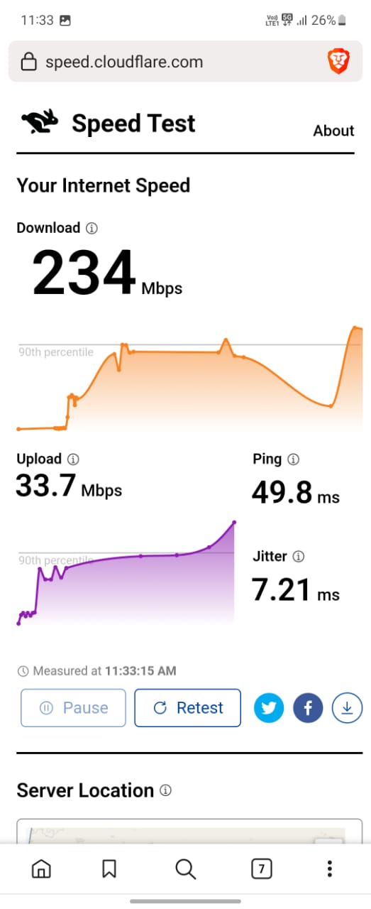

I usually gets speed around 300mbps, screenshot doesn't do justice.
