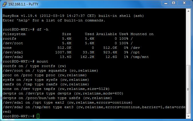

problem with mount
mount
rootfs on / type rootfs (rw)
/dev/root on / type squashfs (ro,relatime)
proc on /proc type proc (rw,relatime)
sysfs on /sys type sysfs (rw,relatime)
ramfs on /tmp type ramfs (rw,relatime)
none on /dev type tmpfs (rw,relatime,size=512k)
devpts on /dev/pts type devpts (rw,relatime,mode=600)
devpts on /proc/bus/usb type usbfs (rw,relatime)
/dev/sda1 on /opt type ext2 (rw,relatime)
/dev/sda2 on /tmp/mnt type ext3 (rw,relatime,errors=continue,user_xattr,barrier=1,data=ordered)
1. Are the drives mounted correctly.why is it /tmp/mnt instead of /mnt?Capture.JPG
2. Can someone tell me how to change the gateway for optware installation.i need 192.168.2.1 instead of 192.168.1.1 as 1.1 belongs to my modem

1. Are the drives mounted correctly.why is it /tmp/mnt instead of /mnt?View attachment 16390

Same happening with me the drive is formatted with ext3 and mounting as ext2...
Dinjo,revo help needed
Think it would be mounted as ext3 if we unmount at startup and then mount again but can anyone tell me why is mnt mounting as tmp/mnt.. @dinjo plz help , also with the gateway thing.

Well the solution to this problem is .. umount the /opt and then "mount -t ext3 /dev/sda1 /opt" ,this will automount the disk as ext3 as long as its physically replugged . And about /mnt->/tmp/mnt , its just the way new systems are mounting the filesystem (linked state) . Nothing me and Dinjo can do about it .. but its not a problem,using /mnt or /tmp/mnt will still get you to the same drive partition.
