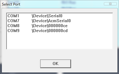

You've to manually close ZTE wireless "APP.exe" via Task Manager and open AxesstelPST, choose the right port and click "Confirm". Maybe ZTE App is accessing the port so PST is unable to use it.

ZTE? I got the Fail Prithvi Modem :dead: Have a Look at Pics Below :#

Then you need to close/end your Prithvi Connection Manager via Task Manager and choose either COM9(first) or COM8 in PST. Let's see if it works
Couldnot Open COM8/COM9 Error :confused:

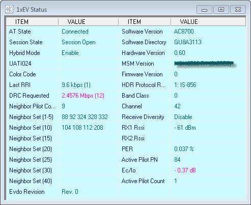

Edit:- I was able to have a glimpse at 2Mbps+ For about 30-40 secs :D[DOUBLEPOST=1366371813][/DOUBLEPOST]

Due to Rain and Bad Weather,Broadband Stopped Working so I had to use the EVDO.While Playing with it! I tried attaching a Pin with a Rubber Band and Speed Shot to Nearly 800Kbps! And Till I kept it attached I managed to Pull 700Kbps + All time! Without it I am stuck at 100~250Kbps! I tried all this while my 1Day Unlimited Plan was about to End! Would have experimented more but I was running out of time!
Then This Without The Pin!
@aryacooldude yes yes.. exactly .. the download speeds are similar to mine in the second screenshot. can you guide on the placement of PIN where to enter it ?
regarding user base I guess it should be tower specific I can beam my repeater's antenna to towers even further than few kms.. I had tested it by changing from nagpur's tower to nearby village's tower. but not much improvement in speeds. signal strength shows -79 dbm all the time.. it doesn't seem to show better strength but i guess it is getting strong signal as my other phones/data cards show strength upto -49 dbm
