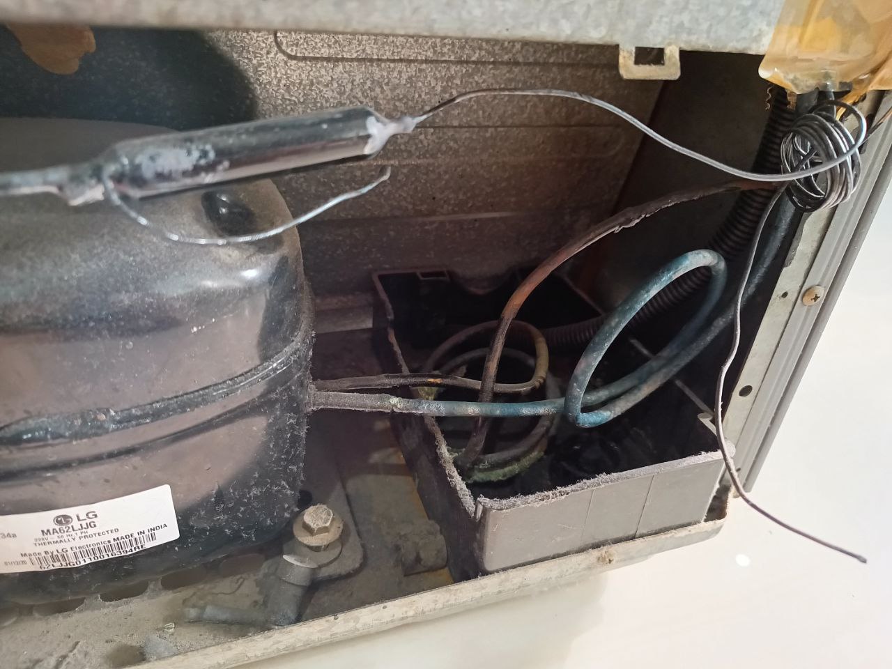

Regardless, Would you guys suggest it would be a wise idea to coat the copper pipes with enamel coating? My area has presence of hydrogen sulphide, sometimes dense, so it reacts with copper forming a blackish layer of copper sulphide. Most of my copper utensils have gone black. The coating should help copper from reacting with sulphur in the air. The local technician did this last year to prevent the copper tubes in the new compressor from sulphurisation. Not to mention corrosion due to salty air.
As you can see, the top tub like structure has the enamel coating, while the pipes inside the water collector tray and one adjascent to it have been sulphurised.
As you can see, the top tub like structure has the enamel coating, while the pipes inside the water collector tray and one adjascent to it have been sulphurised. View attachment 130852
Copper getting oxidised does not threaten structural integrity like say rust on steel which is damaging. That is what you are worried about in this application.
Where copper oxidation is a problem is if it coats electrical contacts and hinders proper contact. Then you will find the appliance or device stops working. Continuity problem.
Now here's the thing. H2S isn't going to damage your copper pipes. Salt water will though. But you are not running salt water through your pipes. It's the atmosphere that has salt in it and that is likely to be a much slower process. I seriously doubt that is enough to cause leaks in your pipes. Don't confuse with steel here. Steel will structurally weaken in such an environment and is painted with enamel for precisely this reason.
If it gives you peace of mind then do it. I'd use a transparent kind of enamel coating (clear coat?) though so the pipe remains viewable. Otherwise paint will just obscure things which you do not want. Polish the copper pipes first before applying the clear coat.

[My area has presence of hydrogen sulphide, sometimes dense, so it reacts with copper forming a blackish layer of copper sulphide. Most of my copper utensils have gone black.
If you use lemon and salt does it restore it ? the salt here only works as an abrasive, its the citric acid in the lemon that does the cleaning.
Problem is within a couple of weeks they will be black again so the improvement in appearance is strictly temporary.
Question to ponder is has the copper on your pots become weaker over time being exposed to H2S and salty air ;)

I coated the copper part of the compressor with the dark one. It was a remaining from the previous use. Should any issue arise, will use mineral oil to remove it.

The coating can help, but I think its oxidized because that is the cold line. The hotter line looks clean. I hope he vacuumed the lines when he changed the compressor.
Many companies have a Blue fin coating that companies apply to AC coils and Lg also has something like a yellow coating, We need to know where we can get them since they don't affect the thermal properties and also protect the copper.
