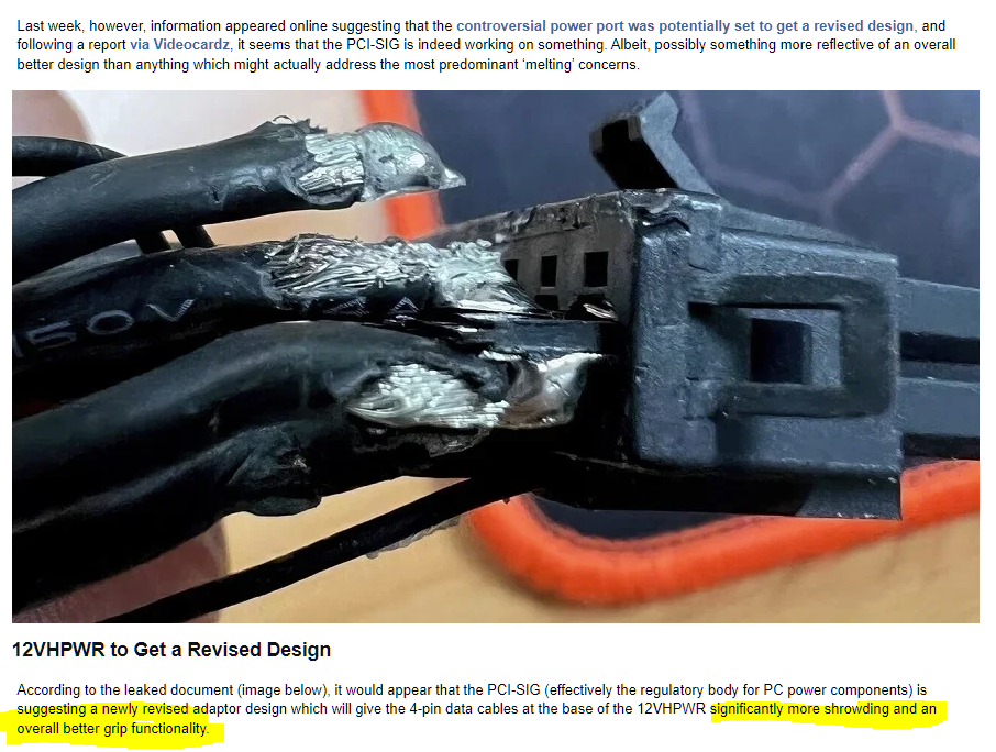

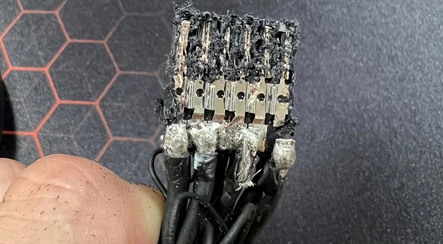

GamersNexus's and Nvidia's own study has shown that it is mostly due to user error i.e. not plugging the adapter all the way in the graphics card power input.
That is such a bad way of putting it and absolving Nvidia of all the blame... If you design a car that requires user to evrrytime solve a puzzle before brakes can be applied... When the user fails to apply breaks... Do you term it as user error? Or is it because of the poor design?
Its not the user its early to market issue and design issue .new ATX 3.0 powersupply will have new connectors.
Why it is not the user issue .The new connector doesn't have enough depth so that it can seat in , maybe it worked when directly connected via 12VHPWR connector from new PSU .But nvidia hands out 3 to one 12VHPWR connector and keeps hanging within the case which acts as pulling force and unseats /unsettles the connector /cable over the time.
Pushing the connector properly is not a puzzle. Your comparison is out of measure. The connector/adapter design is not Nvidia's alone. It is from PCIe sig of which major manufacturers are members
Pushing the connector properly properly is not a puzzle. Your comparison is out of measure
The problem is with the weight of 4 wires and connectors this one connector has to support and that too in a bent state. It is poor design. User has to plug it in fully that's a given but the design keeps putting more pressure on the socket everyday to fail. If you keep pulling a connector by adding weight it will become lose eventually.
Nvidia took the easy way out and said its user error. Ofcourse they want all the money and no blame. End of the day we will just need for more cards to fail till then Nvidia can have its greeds fill
How did you come with the conclusion that weight of 4 wires is a problem? You can hate Nvidia for their greediness and I too for their ridiculous pricing every new gen but that's irrelevant to connector discussion
Sorry I didn't put it in better words. It is surely a bad design. Nvidia is at fault. I was just letting the people who want to buy the 40 series card know that they can rest assured that their card won't melt given they have properly inserted the connector and there's no serious bend to the cable.
