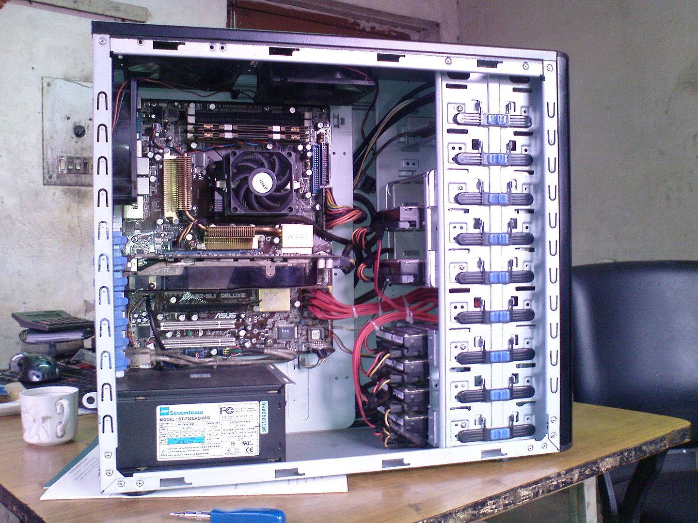

My cable management not good as i am waiting to get new power supply but here are some pics of my pc :P

Here are more pics:
Forgot to clean it before taking pictures, thats why its a mess.

Need for a better cabinet :(, everything is now a tight fit, reaching the sata port will a PITA.

Tats still neatly done inside dat SLB.. :D
DP, are those Dominator airflow fans really reqd in ther?? Dun think so unless u're stressin 'em @ really high voltages..

Right now the airflow in my CM 690 is pathetic hehe, have to rearrange all the fans in my cabinet (bikey gave some good suggestions).

@Saiyan - this Case is not that good either, when I got it the HDD temps were around 43C during the cooler rainy days, the airflow from front intake fan was blocked by a nylon air filter and a Aluminum plate with holes which restricts the air a lot, and lastly the holes on the sides of the HDD cradle are very small for good airflow. So I removed the nylon filter and cut out the Aluminum plate using a Jigsaw I also joined the holes on the side of the HDD tray by cutting out the metal between the holes - the HDD temps now on a HOT no-rain day is 36C. Of course I have added the extra fan on the inner side of the HDD cage which you can see on the right hand side in the pictures, in the first picture this has a Blue Vantec fan and in the second picture I have changed this fan to a 4 colour LED Amigo fan. This one extra fan really drops temps of HDDs GFX card CPU and North/South bridge chips.
This case has 4 120mm fans on the side panel and these 4 fans like the name of the case gives a BIG FAT "ZERO" drop in temps to CPU and GFX card and the North and South bridge chips. :( All these 4 120mm fans seem to be good for is to throw dust into the case. I dont power these side panel fans - really makes no sense to run them because of their lack of cooling.
This case came with 7 120mm and 1 80mm fans (all fans are included)
EDIT: Message for BIKEY !!! THANK YOU for not taking the SI-128 heat sink I really need it in this case as the TRU and TRUE were hitting the side panel fans !! Difference in CPU temp between the TRUE and SI-128 is max about 1C !! :ohyeah:
