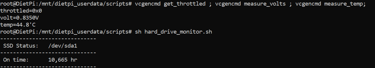

"vcgencmd get_throttled" tells you (amongst other things) all the Pi knows about the quality of its power. To get any more you need an analogue to digital convertor to measure the key voltages -- mainly the 5V rail, possibly battery if you run from one.

Got it. Let me first arrange the official power supply. Thx
No first run those commands and check the voltage and if its being throttled.

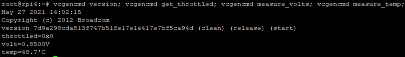

Oneplus dash charger + raspbian lite on samsung evo 64gb sdcard.

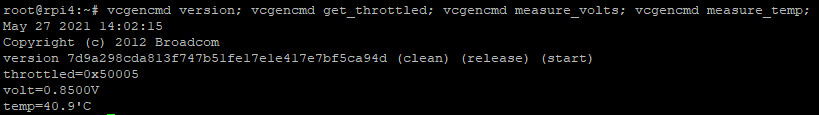

2nd charger
Update .. the throttling shown above happens when I attach a usb tester to the link. It shows fluctuating voltage + current .. Although once I removed it, the vcgencmd shows 0x0 as throttled

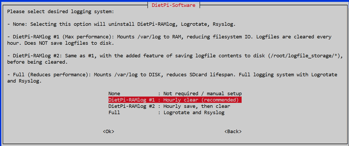

BTW I use dietpi which writes system logs to ramlog by default. Saves a lot of writes to the SD card which adds to the life expectancy as well.

Simply put one conclusion could be that the headroom for spikes is very less with the charger. So whenever there is a spike, say high cpu usage, or usb drive usage etc, there are power issues.
Get the original power supply, your issues should be gone. It will also be cheaper than any further testing or equipment purchase.
