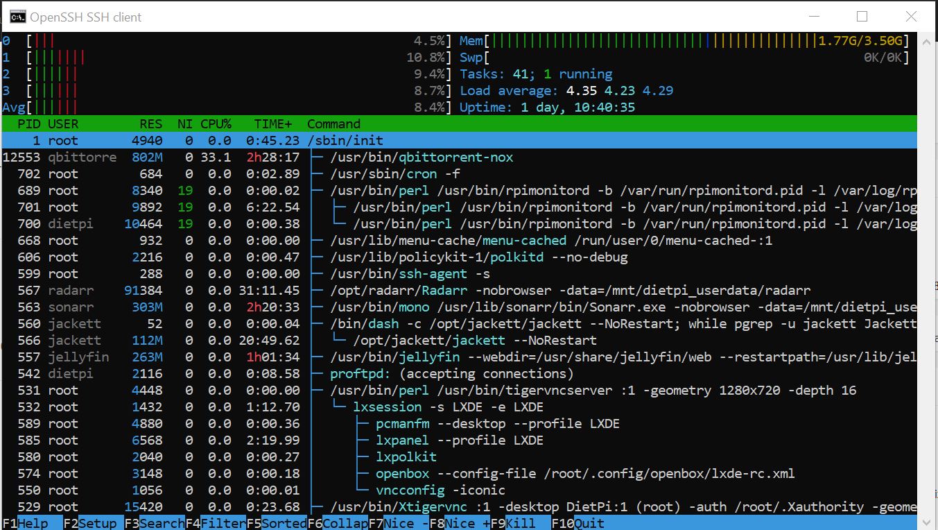

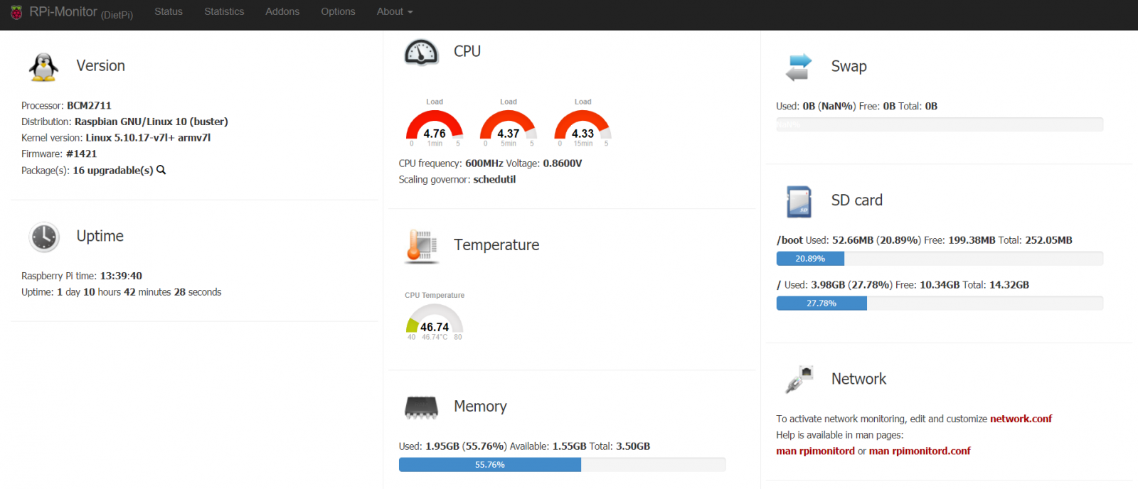

Does anyone know if qbitorrent is supposed to be so much heavy on system and that too with only 11 torrents (some 25GB) but actively downloading only 3 ? It is also using 30%-60% CPU right now.

You have some updates available, try updating and see if that helps, also check out Deluge
The CPU utilization is not so high, but the load average is. Where is this downloading to ?
Seeding 40 torrents.
