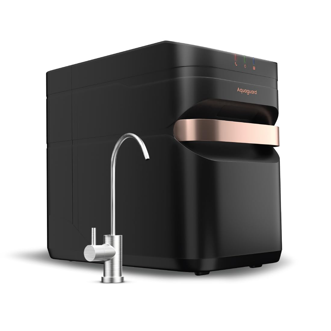

Mounting Type... / Table Type / Undersink Type.
product-500x500.jpeg Undersink Type.
It really depends on your preference. Mounting Types are Wall Mounted.. Table Types are put on the table... and Undersink types are used in households having smaller kitchen or no space for wall mounting and table.
