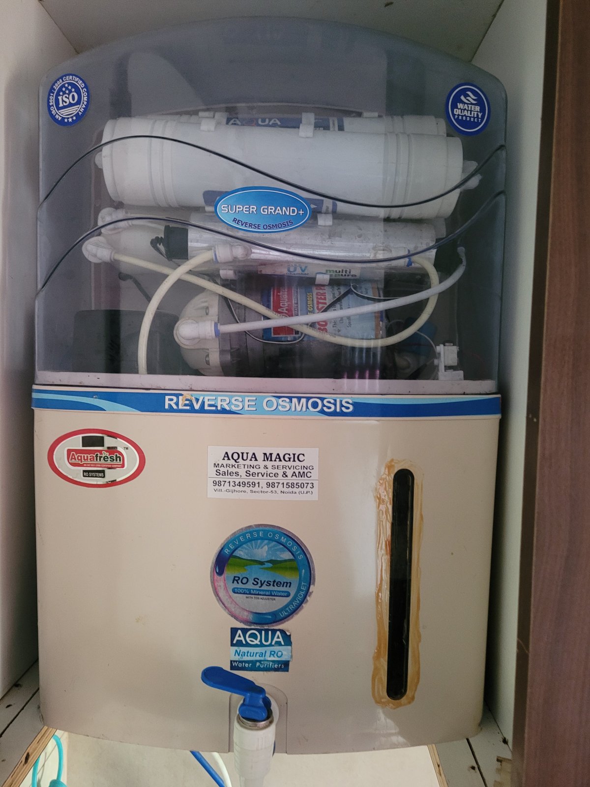

please recommend.
thinking of this model aqua
what about purifiers having alkaline water option? seems gimmick.
was checking eureka forbes and not a single model is without copper, alkaline, zinc.
looking for a new water purifier most probably should have a steel tank.
my water source is borewell tds is about 600
please recommend.
a generic ro would do for 600tds. as per indian standards, 500tds is the upper limit for potable water. https://www.amazon.in/Copper-RO-Purifier-Automatic-Controller/dp/B0BJ6P3LSK or https://www.amazon.in/Kinsco-Adjuster-Purifier-Dispenser-Machine/dp/B09GLW2F7L under 5k, gets the job done. can be maintained by yourself. what is your use case for steel tank? alkaline water is gimmick 99% of the cases. only valid use is in case of hyper acidity that alkaline water would help.
