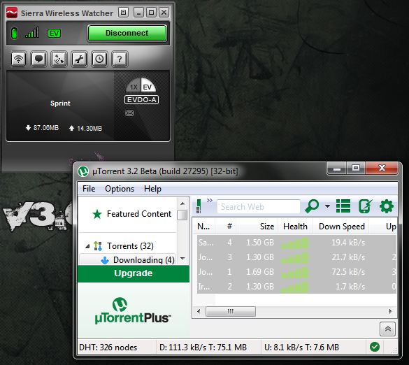

View attachment 12220 View attachment 12221 See the difference between prithiv I stay in EVDO gold mine area but sierra aint doing good job with download speed but prithiv did !! not sure whats wrong . cisco_tech & kuduku ?? any inputs ??
with the available signal strength and time of posting the screen shot combined with the utorrent usage i feel the download speed is perfectly fine
try with idm in night or utorrent with only one download running with good seeds in night

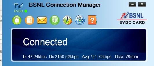

IT shows you have full signal !! hmm i dont understand with the speed test though ... Try downloading any software using idm that will be the real test :) CONGRATS !! I am happy for you...
@Dushie : your modem is rev A. but it should show connected to evdo but it shows evdo & 1x go to settings change it to evdo only & try again...
