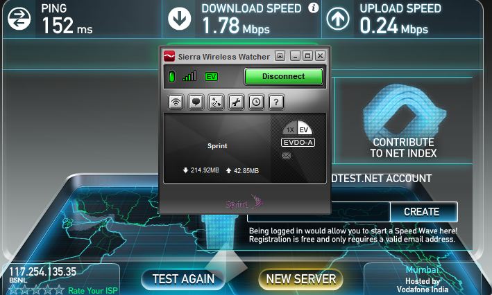

speed test with low signal -91dbm.

SPEEDTEST DOESNT SHOW CORRECT SPEEDS FOR EVDO . I am getting 150 download speed and according to speedtest i have .25Mbps connection . Use IDM or only one torrent with good seeds running and global maximum number of connections not more than 200 and connected peers per torrent 30 . Best is use the utorrent guide to set it up correctly

will do so and dont get disheartened , try the speedtest in night and try moving the modem in your room and if doesnt work out adequate people are ready here itself to buy the same
kuduku : at office on my laptop, can't install utorrent here, will surely try once at home. Also will try and check IDM, i have the older version,Didn't know there was a specific setup guide for utorrent. I just run it on defaults after opening the port.
But i find the browsing to be a bit slower, with pages taking more time to load, can we do anything for that.

Yes, it's reliance wll. will post a pic of the antenna and box. Night speed test was ok, nothing great at -76dBM i was able to get a max download speed of 60 to 70 kB and was fluctuating a lot.
Current screenshot also shows full signal at -76dBM but speeds are max upto 25 to 30 kB/s in utorrent.
