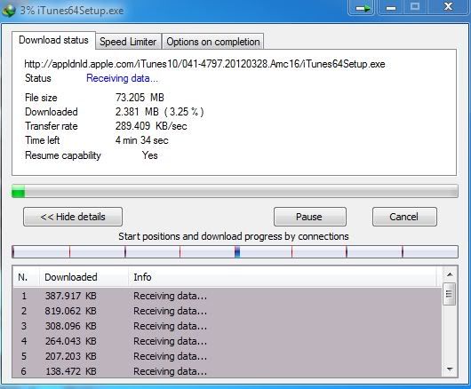

SpeedTest
See the Signal Strength. #[member='kuduku'] was telling me are you sitting on the tower ?
On previous ZTE REV 0 Device - browsing was slow, speed was 200-240 KB fluctuating a lot.
On current Sierra REV A - Browsing is much much better due to REV A connectivity. and speed now doesn't fluctuate that much. constant 280-320 KB.

SpeedTest

man you are going to rape them . Its first time in my life in forums i am reading that somebody had got signal strength less than -50db . I had tower 500 M away and the best i could get even with a patch external antenna was -51db . You are really going to enjoy this EVDO connection . What is the maximum download speed you have touched ? 370/400 ?? What is the consistent download speed now ? 370 i can see in idm screenshot . Theoretically you can get 396 as download speed .....

#[member='kuduku'] it always settle between -46 to -49. Maximum i have touched is 385 KBps and consistently i get about 340-360 KBps. but during day time Max i get around 240-260KBps. because of active connection on tower.
